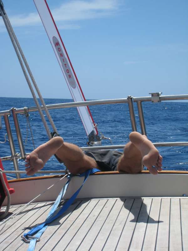

We have a Bowman 57 and love our Monitor windvane. We learned why and were grateful that it came with a replacement post as the forces in storms did indeed stress the system. This is Alex repairing one of the issues mid-Atlantic while we were hove to. I 'll get Alex to give you more of the technical perspective.
[attachment=274]IMG_0432.JPG[/attachment]
