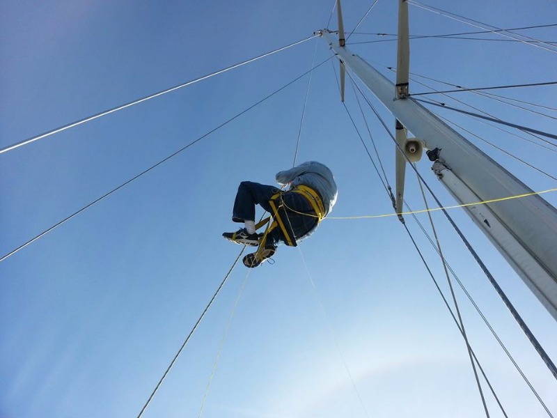

[attachment=477]10329264_1020374.jpg[/attachment] Past Commodore John Franklin has suggested developing a paper on best practices in mast climbing. I am opening this thread to gather expertise and advice from our members. I invite Alex Blackwell to tell about his experience with the Topclimber, a useful tool for single or short handed sailors that requires great care to use safely.
Alex Blackwell - 24 Mar 2017
Yes, the Topclimber is indeed a very useful piece of gear. It eliminates the need for someone on the winch to haul the working crew member up the stick. The Topclimber is basically a pair of cam cleats attached to a non-stretchy rope and then used to climb up this rope with minimal effort. Like other similar products it is derived from mountain climbing gear. More on our decision making and some initial lessons learned here: http://cruising.coastalboating.net/Seamanship/Workingaloft/WorkingAloft.html However, as with all tools or equipment there are health and safety things one must take into consideration; ->Equipment must be thoroughly inspected before, during and after use ->Backup plans must be in place prior to use. 1. A misdesign in the equipment caused a failure which I fortunately saw while at the top of the mast and even more fortunately was able to rectify. Had I not done so, I would most certaily have fallen the 60+ feet to our deck. 2. Having a second harness with a second halyard tailed by a crew member would have averted the above mentioned almost disaster. This is something we now always deploy - lesson learned. Here is a more detailed recounting of what happened: http://cruising.coastalboating.net/Seamanship/ATN/ATNTopclimber.html
