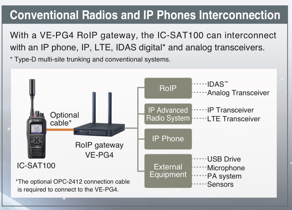

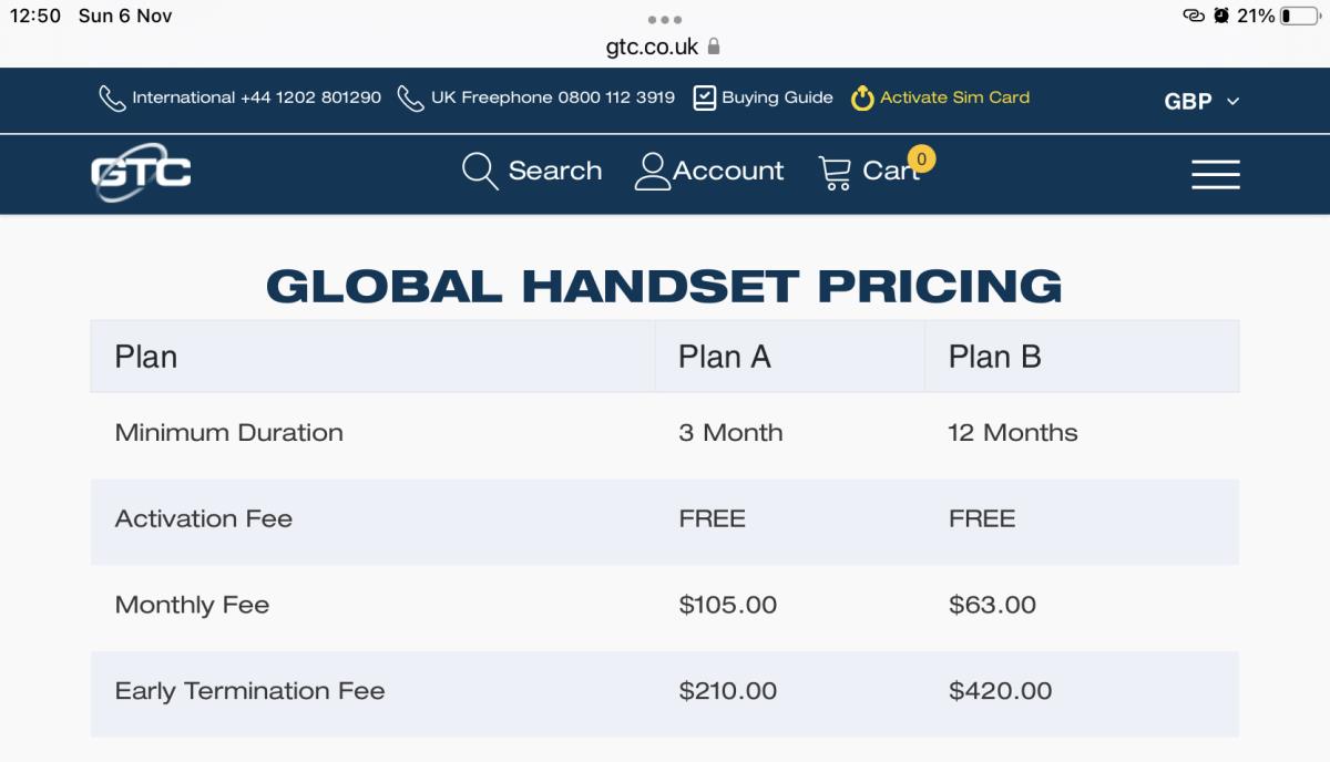

Thanks for your feedback Dick,
I have absolutely checked previous forum SSB articles, but couldn’t seem to find what I was looking for.  To answer your question, this ICOM sat100 PTT & VE-PG4 radio gateway seems to have the benefits of being cheaper, while also integrating with my boat’s existing systems and providing satellite data.
So, I attach a couple of photos to clarify;
Click To Enlarge Click To Enlarge
Grateful for all guidance, input and feedback,
Best wishes,
Sonia

Hi Sonia,
Most of that is above my pay grade.
When in the higher lats, I did use a sat-phone with a link to my computer for verbal comm and for weather and emails. It worked quite well, but was not an unexpensive solution, although pretty appreciated.
What do you hope for with the system you are designing: email?, weather (text and/or surface analysis’s?, verbal conversation?, position reporting?, emergency reporting/consultation?, surfing the internet?, etc.
A comprehensive list of what you wish to accomplish should be helpful at narrowing the choices.
Whatever you choose: use it at sea before your trip. There are too often surprises that are impossible to deal with without support.
My best, Dick
