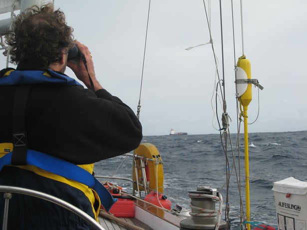

[size=5]Ten tips for keeping a good watch[/size]
[attachment=106]Watchkeeping.JPG[/attachment]
1: Follow the vessel 's Standard Operating Procedures (SOP) for decision-making
2: Get plenty of rest in the off watch period
3: Wear the right gear for comfort and safety
4: Hydrate and snack to stay healthy and alert
5: Check the course and the sail trim (esp. if using self-steering)
6: Use binoculars to scan the horizon for ships and weather and to check the rig
7: Check electronics (radar/AIS) for ships not seen
8: Update the ship’s log hourly
9: Put on the kettle before the next watch
10: Give a thorough briefing to the next watchkeeper

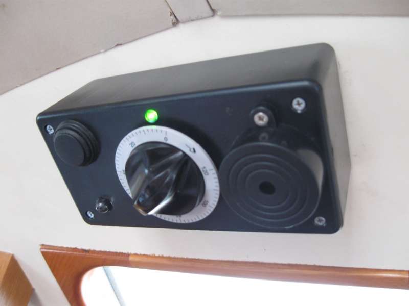

Now I 'm single-handed, and I 've made a watchkeeper 's alarm using a clockwork run-back timer, activating a bright red LED and a 90db piezo buzzer when it reaches zero (with a dim green LED to tell me that it 's active and counting down). All components can be found at RS components.
[attachment=111]image.jpg[/attachment]
I also make much use of my Vesper Marine AIS and my CARD radar detector.
