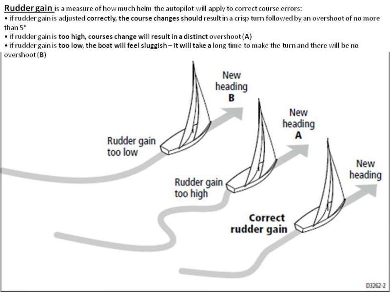

We purchased a Raymarine autopilot (used), and spent the season last year calibrating and recalibrating it. When engaged it steers our boat in sinus curves with ever increasing amplitude and increasing violence. Very scary. Raymarine has not responded....

FYI… Alex finally managed to get an answer from Raymarine through our friend Will Sayer who works for them. It turns out that Raymarine autopilots have an internal gyro that whigs out on occasion. It is a known problem. They sent us a complex series of diagrams about how to open the machine and disengage the gyro. Meanwhile, Will suggested we just send it back to them to have their techs do it for us. As it turns out, there is a standard charge of £40+ for simple diagnosis of the problem and more than £400 for any repair, which has to be paid up front. That was great incentive to attempt the job. Alex was successful and we finally have an operational autopilot. If anyone else has this problem, please let us know and we 'll share the diagrams (which are hand drawn by the lead tech and hard to decipher but they worked).

Hi there As it turns out our problem was 'fixed ' by disconnecting the internal Gyro. This is not saying that this is a universal solution. it worked for our STG3 course computer. I have attached several files for you to review: Raymarine STG3 repair: this is a synopsis of emails from the tech at Raymarine when we narrowed our problem down. Fluxgatetest: do this before the prior doc (this one is for Simon) Rudderrefferencetest: do this one first Carolyn: friends of ours also had a voltage problem. On investigation we found that the 'professionally ' installed power cable was way too small and that there was a significant voltage drop. There are charts available that show voltage drop based on power consumption and cable length/diameter. With a big draw like an auto pilot,always go a size or two bigger - (just like you would with an anchor ;) )
