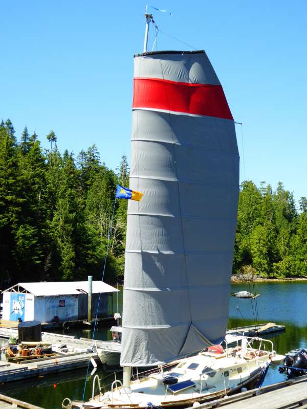

Fed up with the difficulties of handling your bermudan rig? Don 't be downhearted! There is (very nearly) a much better alternative. [attachment=159]P1000146.jpg[/attachment] Beneteau have realised what a massive turn-off the bermudan rig is, to those who are new to sailing: [url=http://www.beneteau.com/Sailing-Yachts/Wing-Sail]The Beneteau Sense 43 Wing sail prototype[/url] and: [url=http://www.yachtingworld.com/blogs/matthew-sheahan/536493/beneteau-s-wingsail]Matt Sheahan 's YW article[/url] and for the DIY-friendly, user-friendly, downmarket, low-stress alternative, my own offering: [url=http://www.boatdesign.net/forums/boat-design/design-soft-wing-sails-cruising-49425.html]Soft wing Sails for Cruising[/url] I 've been sailing with my new wing sail on the W coast of Vancouver Island; not much sea time yet, but it 's looking promising. This is a single sail of 54 sq m, as opposed to the ketch rig with wing sails that I sailed with on Tystie for 40,000 miles. No, really, this is the future. I predict, with my tongue only slightly in my cheek, that in 50 years time, the bermudan rig will be looked back on, much as we look back on gaff rig, as being "well, as good as they could manage to invent and make at the time, and as suitable as they could make it for cruising, with the technology and materials they had, but oh! what a relief it is to sail the way we do now..."

[quote="alshaheen" post=1497]David I find this fascinating and you are obviously well versed in the theory and practice. Would you like to write a technical article for Flying Fish? John[/quote] Yes, I will, as soon as I 'm sure that i have everything as good as I can make it, sound, strong and reliable. I 'm getting the performance I wanted, amd the ease of handling I needed, but there are still some question marks over the structure of the battens. Two days ago, I ran up the Juan de Fuca Strait, which was in its usual summer mood, ie, fog and near gale in the afternoon. I needed to haul down reefs whilst on a dead run (can you do that with most bermudan rigs?) and the battens found a way to capsize, rotating on their axis, and getting damaged in the process. I retired into Sooke Inlet for a day of deep thought, and I believe I know what I have to do. It 's back to something similar to what I left England with, in 2006, but now in CFRP, lighter and stiffer, easier to assemble - and, I hope, stronger. The perils of being a pioneer. Yes, when I have everything sorted out, I 'll write. But not until then.

Yes, John, it can be done, if you have quite a lot of expensive hardware, do things exactly right, and put on foulies, boots and harness to go the the mast in the rain and rising wind. Compare with junk rig - ease away the halyard, trim the sheet. Job done. Compare with my wing sail, when I 've got my batten issues sorted - ease away the halyard, hand-tension the downhaul, trim the sheet. Job done. Single-handed (literally, while I steer with the other), from the companionway. I know which I 'd rather be doing.
