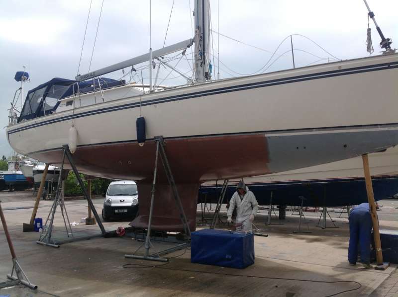

Simon Currin - 30 May 2013
Well I have taken the plunge and gone ahead. It 's turned out less expensive than expected. Excluding the prep it 's cost just twice what we spent on conventional paints last year. [attachment=80]image_2013-05-30.jpg[/attachment]

Simon Currin - 17 Sep 2018
Five years on and we are very pleased especially as for 3 of those years the boat was continually in the water with no lift and scrub facilities. We hauled out last week and have a clean hull. The coppercoat is looking a bit patchy especially near the waterline where it has been gouged by ice. Tomorrow we are going to give it a light sanding and then a few more top-up coats.
