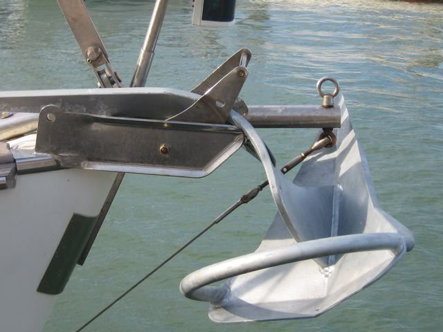

In 2007 we upgraded from an undersized Delta to an oversized Manson Supreme and we have certainly noticed the difference. It 's a lot less fiddly to set and only once has it dragged. We have had a few problems but overall we are pleased with the investment. The problems we have had are as follows:
1. The time it dragged we were anchored on a kelp strewn sea bed with too short a scope but when it dragged the roll bar must have temporarily snagged a rock on the bottom as the weld connecting the roll bar to the fluke of the anchor failed. Obviously this didn 't impact on the structural part of the anchor but it did mean that we had to get it welded up. We corresponded with Manson in New Zealand who were very helpful though of course we got it welded locally.
2. We never changed the stem fitting when we upgraded. One of the attractions of the Manson is the slotted shaft which works a bit like a tripping line if the anchor gets stuck. We used this slot during the first season but found that the anchor was very unstable as it came over the roller during lifting. On many occasions the anchor fell off during lifting and damaged the top sides. Since then we have not used the slot but have used the the fixed connection to the shnk and we have no recurrence of the problem. I guess the message is that if you want to use the slotted shaft you may well need to modify your stem fitting to make it deep enough to accommodate the relatively broad shank.
