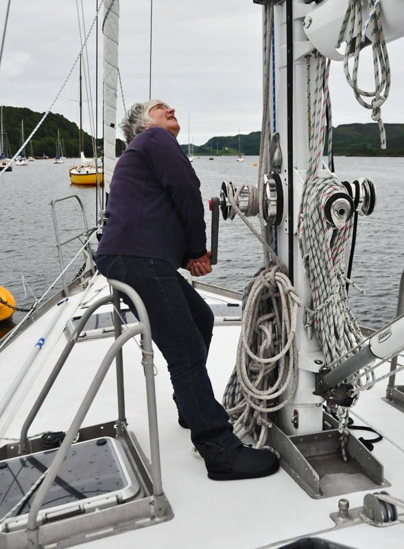

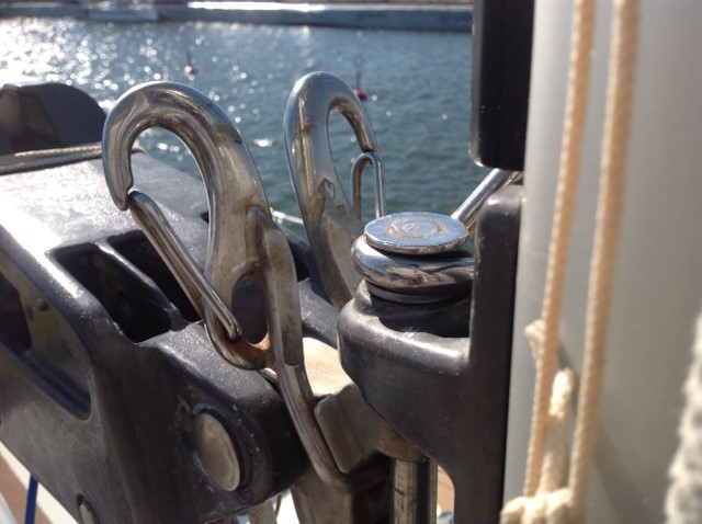

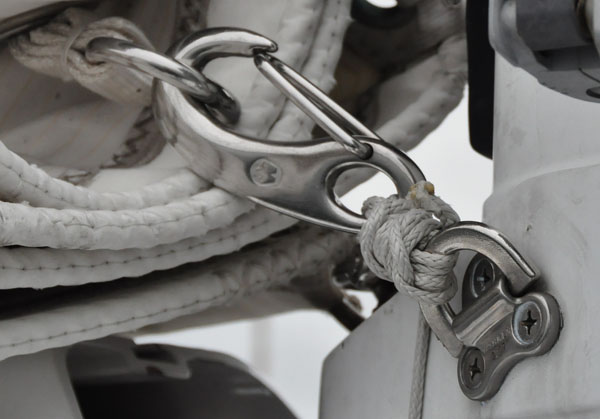

Great work Tony. Agree with most of it, including that it is best to reef at the mast. The mention of SS rings on webbing through the luff reef cringles suggests ring 1" or 1 1/2" diameter. To me, 1 1/2" is minimal. We have 40 mm rings made of 8 mm diameter rod, which have worked well for 30,000 miles. A big Wichard snap shackle is the best way of attaching them, as you say. I like you welded on hook idea, but it may not always be practical, particularly for 2nd and 3rd reefs. Our hooks are on short lanyards to eyebolts. Mast pulpits are a huge help for reefing at the mast. It is easy and safe to work with both hands on reefing. Our pulpits are 25" high (a bit higher may be better, but too high would impede arm movement for winching) and 29" outboard of he side of the mast. Many I see are too close to the mast. [attachment=258]Mastpulpit.jpg[/attachment] [attachment=259]Wichardhooktoreefring.jpg[/attachment]
John Franklin - 13 Aug 2015
Niel The photo of the reefing rings in Tony 's paper was taken on Al Shaheen. Our rings are the same size as yours and I agree the desirability of rings this size. We have a slightly larger Wichard clip than the one you show and have no difficulty in attaching 3 reefing rings on the same side of the boom. The advantage of a fixed, welded, Wichard clip is that the rings can be clipped in using only one hand. It is best to lave slightly longer tapes between the rings for the 3rd reef. With a reefing winch mounted on deck, just aft of the mast, I sit on deck (low centre of gravity) when reefing, with a clear view of the reefing cringle in the leech. We keep a short tether permanently attached to the gas strut fitting at the base of the mast and work there with 2 tethers to limit potential falling distance if dislodged.
neilm - 13 Aug 2015
Agreed that welded Wichard hooks are the best, for the reason you state We have no good location to attach them. In addition we have Battcars instead of sail slides, so the second and third reef rings are pretty high, although your idea of making the correct length web could perhaps solve that.
