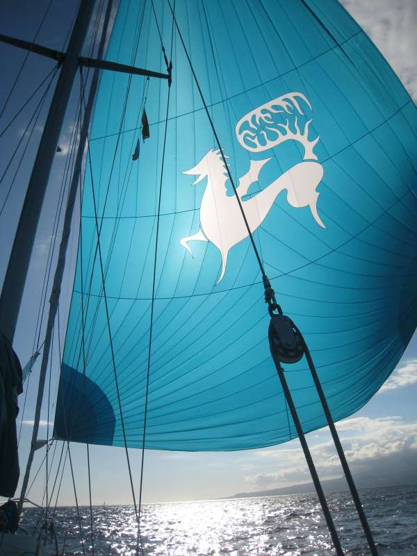

We love our asymmetrical with sock. This is me on watch mid-Atlantic. We cannot fly it in more than 10 knots of wind. Just too powerful. But like you, we hate to run the engine if we don 't have to. This sail gives us more options for sailing on passages.
We also have a mizzen staysail (like a spinnaker for the mizzen mast)that tore the first time we put it up. Have had it up only once since, but Aleria looks quite beautiful with it filling in the sail area between masts.
Each of these sails can add a knot or more of boat speed which can make a big difference over long distances.

Hi Daria,
Those were wonderful pictures.
As to a mizzen staysail spinnaker, a few use them regularly, but most descriptions of their use I have heard have to do with a photo opportunity where they perform admirably (and then are put away again).
Your asym sounds like our original asym. We wanted a broader range of wind speeds, and an asym that could stand up to upwind sailing, so we went with our previously described choice. This may loose a fraction of boat speed in the lighter winds, especially DDW, but increases the usability overall enough for us to be content. As said before, we just want to keep moving nicely and not turn on the motor.
