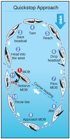

Quick stop maneuver for MOB retrieval
Daria Blackwell - 11 Jul 2015
There is a good article in the BOAT US magazine about MOB techniques for different vessels. It includes a useful graphic of the quick stop maneuver. It 's a good thing to practice with crew before it is needed. http://www.boatus.com/magazine/2012/October/foundation-how-to-prepare-for-a-man-overboard.asp
