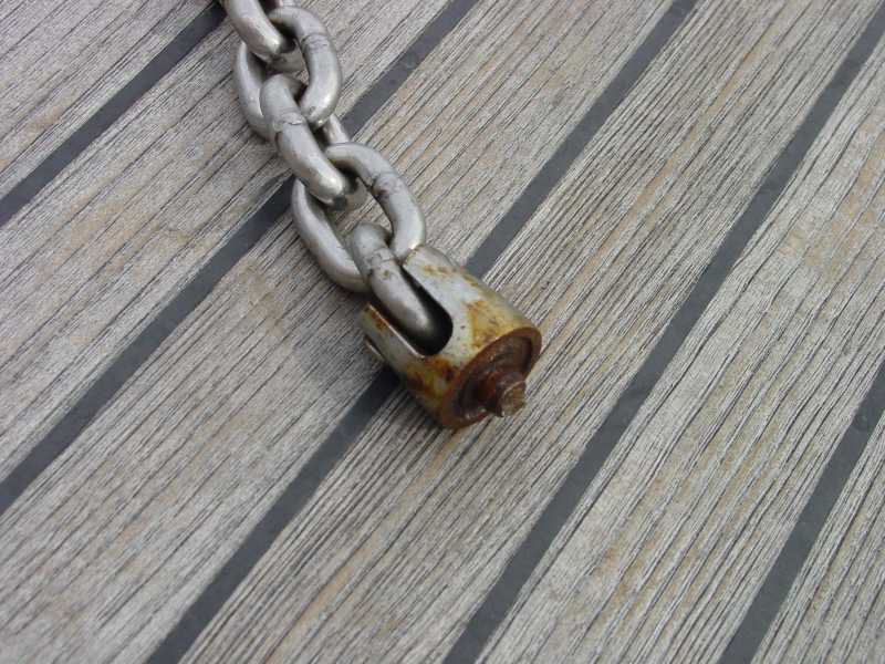

Bill yes it may be time for a re-think! What disturbs me most about John 's photo is that I think it was the the same model as ours. Looks like most people carry a lot more chain than us too so plenty of food for thought.
Alex and I are not proponents of swivels. One of our main reasons is that you cannot see inside the housing of most swivels to be certain there is no corrosion; this is especially important for stainless steel swivels which are particularly susceptible. The Quickline cast SS swivel was recalled a couple of years ago and there was a good discussion in Practical Sailor. http://insidepracticalsailor.com/quickline-recalls-cast-stainless-steel-flip-swivels/
Friends of ours lost two SS anchors off their bow while underway. First one sheared so they replaced it with am "improved version". Then the second failed. In both cases the swivels sheared at the pin. See photos. The swivel pin was not visible inside the housing and corroded in a very short period of time. The corrosion is particularly aggressive in wet areas - like on the bow which is always subject to spray.

[attachment=22]DSC08867.JPG[/attachment]

Scary thought and photo John. And it would happen just when things are hairiest out there. Thanks for sharing that.

The (top) photo on John Herries ' post is in fact a (much better!) photo by John of my failed swivel.

Stainless steel is a tricky material at the best of times. In spite of excellent tensile strength it is susceptible to stress corrosion cracking, especially in the presence of chlorides. I would not have stainless steel in any part of my ground tackle - not shackles, anchor or chain. Remember, the strength of your ground tackle assembly is the strength of the weakest link.
There was a very revealing article on stainless steel chain published in Flying Fish a couple of years ago...
I 'm with you John, about SS being tricky. I would not trust it for any part of the tackle arrangement, except possibly the anchor. Again PS did a good job of reviewing the issues.
