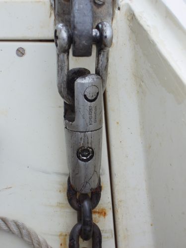

chrisdevans - 21 Apr 2012
We have a 32kg Delta and a high grade galvanised 4-part commercial shackle connected to around 6" of chain, THEN the Kong swivel, then the main chain. This ensures absolutely no potential problem with sideways pull (even though swivel is rated to 2T WL sideways). The issue to me is one of matching the MWL and breaking strain with all the components. No point is a 2T max working load on chain if swivel is 1T - you really do have a weak link. This assumes reputable manufacturers of components telling the truth on MWL and breaking load!! Before this set-up we did have a mismatch with a lower grade swivel connected directly to the anchor, and over a season with many anchorages, the swivel did warp due sideways load. Luckily did not break, but easily could have in a blow. Lesson to me is buy best possible quality components and make sure they are matched in specification, or at least the joining parts (shackles/swivels) are rates higher than the chain.
John Franklin - 21 Apr 2012
Chris makes an important point here - inserting the swivel in the chain rather than having one end attached to the anchor stock or even to a shackle on the stock. For the integrity of the swivel it is vitally important that it must have full articulation. We have not used a swivel aboard Al Shaheen since ours parted in Chatham Bay, Union Island one dark night and we nearly went on the rocks. During a short period of intense katabatic downdrafts the boat had sailed to the end of her scope (30 metres of 10 mm chain), several times and come up hard when the chain became taught. The gusts dropped as quickly as the came and all was quiet so we didn 't know that the swivel had parted company with the chain. When the pull of the chain on the anchor (20 kg CQR)came at an angle to the anchor stock it severly strained the fork of the swivel, resulting in the forks opening and pulling the pin out.....No connection! I 'll post a photo of the failed swivel when I can find it.

chrisdevans - 22 Apr 2012
Johns horrible experience with a conjoined double shackle type swivel (I am assuming from description of failure) is very much the same as where we were heading with our problem twisted swivel. Our new one is the Kong swivel which is very clever in that there is basically a two part manufactured piece - hard to describe - so both chain and anchor connections cannot twist out like shackles can. Recommend check out Kong website/catalogue. The Kong is more expensive than most, but seems to me to be money well spent. The extra chain between swivel and anchor is obviously only possible if windlass is sufficiently far from roller. It also does avoid extra pressure on swivel over roller when not directly connected to anchor. Chris SV Tulu of Fowey

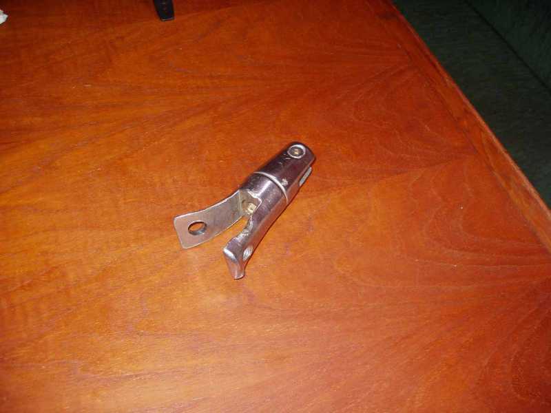

John Franklin - 22 Apr 2012
[attachment=16]Anchorconnector.jpg[/attachment] Here 's the photo of the failed swivel. The opened yoke had been attched to a "D" shackle on the end of the CQR stock. The pin of the shackle was through the hole in the anchor stock and the pin of the swivel yoke was through the "D" of the shackle. I think that on one of our violent perambulations the chain must have come up tight leading almost parallel to the anchor stock causing a twist across the jaws of the yoke, which just spread them open (13 tonnes of boat travelling at 2-3 knots) and popped the pin out. This is how the swivel was when we hauled up the chain, with the other (smaller) end still attached to the chain.

The (top) photo on John Herries ' post is in fact a (much better!) photo by John of my failed swivel. John F

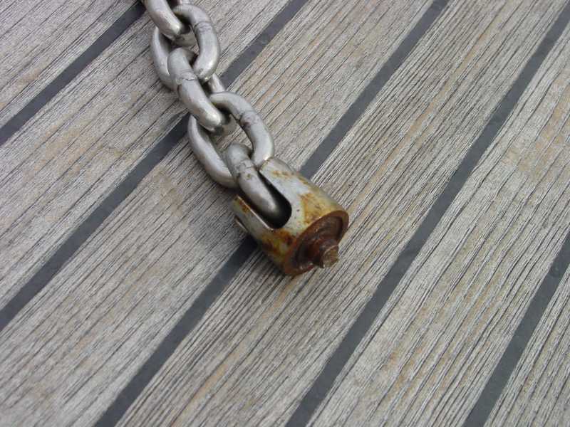

Here is a report on failure of a Kong swivel. It 's a type of failure I had not seen before. http://www.latitude38.com/lectronic/lectronicday.lasso?date=2009-05-15#.VcjUivnG-PV
Dick - 10 Aug 2015
Hi Daria, Pretty dramatic pictures. I have seen this before, but it is not as common as the "jaws-pried-open" failures that have gotten more press. With all the publicity it is hard to believe that people still attach this style swivel directly to the anchor. It is a failure waiting to happen. My understanding of this particular failure underlines why I believe stainless steel has no place in ground tackle. I see this failure developing when side loads (or poor manufacturing) give rise to a crevice which then blossoms into crevice corrosion in hard to inspect places. This leads to the catastrophic failure that stainless steel can be prone to. My best, Dick Stevenson, s/v Alchemy

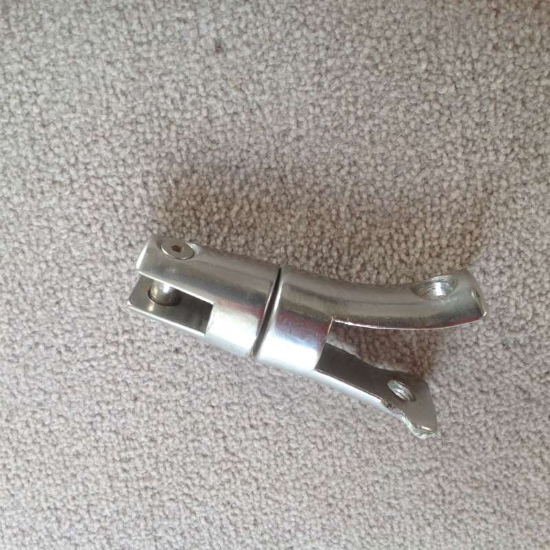

John Franklin - 02 Oct 2016
This failure nearly caused a stranding on a rocky beach. [attachment=435]IMG_1123.JPG[/attachment]
Dick - 02 Oct 2016
Hi John, Thanks for this contribution. A picture is worth a thousand words. Dick
