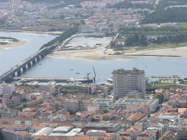

Viana do Castelo – 41°41.22'N, 08°51.38'W
Date Submitted: November 2007
The marina is situated in the River Lima.
Avoid the end of the mole as a bar can build up between it and the first port hand buoy.
The leading line actually leads into the shipyard whilst the marina is in the river itself but the channel is well buoyed so once the pier end at the shipyard is identified on the north shore turn to the east and follow the river, favouring the north side.
Channel dredged to 8 metres.
The river is crossed by a metal bridge (built by Eiffel) the marina is to port (north shore) immediately before the Eiffel bridge.
The marina entrance itself is crossed by a pedestrian swing bridge which swings out across the river when open.
There is a reception berth in the main river itself which can be used if the swing bridge over the marina entrance is not open and vessels are also permitted to berth there over night.
Within the marina berthing is alongside but against very short pontoons. The Longest pontoons are located just as you enter under the swing-bridge.
The marina entrance itself has an obstruction at 2.5m depth, LWS.
Reception is in the new buildings 50 yards beyond the marina to the east. Staff are very attentive but do not appear to respond to vhf.
Swing bridge normally left open at night.
Things to see: Santa Luzia Temple on the top of the hill. For those not wanting the walk it can be reached by a vernacular railway. The railway has recently been refurbished and the entrance is quite hard to find, ask for detailed instructions at the marina reception.
At the main docks on the north shore there is an old hospital ship that is now a museum the ‘Gil Eames’.
For those interested in authentic regional food as for the ‘Three Pots’ restaurant ‘Os Tres Pottes’.
Pictures: Marina entrance with swing bridge open. Taken from Santa Luzi.

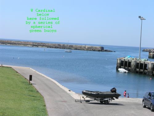

Povoa de Vazim – 41°22.83'N, 08°46.27'W
[attachment=359]povoa-from-south.jpg[/attachment]
Povoa from the South Shore showing West Cardinal Buoy
The staff at this marina are particularly helpful. Berthing is alongside.
Take care to identify the cardinal buoy within the harbour and treat it accordingly, it marks a large shoal area. The diesel/reception berth close to this area is unused (for diesel visit the fishing area) so visitors would be well advised to pass the first hammer head to port, turn to port and berth at the first available berth which will then be bow in to the prevailing wind direction.
There are good haul-out and repair facilities.
If considering leaving your boat for some time this would be a good location, the prices are very reasonable. http://www.marinadapovoa.com but caution the email contact is not as listed above. It is: marinadapovoa@mail.telepac.pt The metro at Povoa (15 min walk from marina) provides access to Lisbon and to Porto Airport (service every 20 mins, journey around 45 mins). Porto Airport can also be reached by taxi if in hurry, booked at the marina reception.

As you enter between the moles there is a shoal area north of the Eastern mole marked by green buoys but also spherical green buoys. None of them are lit. In addition there is a West Cardinal marking a shoal which comes out from the shore. The topmark on this buoy is very unclear and many yachts mistake it and pass the wrong side. Leave the Cardinal to port as you enter. The reception dock does not appear to be used and is very close to the shoal area, the visitors pontoon is the first one you come to, the fingers are very short so rig a bow line and a spring from amidships. It is best to moor bow in, facing North so pass the first pontoon and then turn back to moor on the south side of the first pontoon.

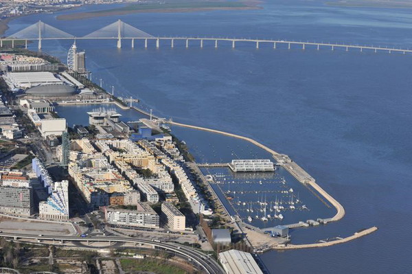

Marina Parque das Nacoes – 38°45.36'N, 09°05.55'E
[attachment=358]Parque_das_Nacoesa.jpg[/attachment]
Marina Parque das Nacoes is part of the Parque Expo Group and is situated 1.5 miles downstream from the Vasco da Gama Bridge and about 7 miles from the Belem Tower on the Tagus River where the Expo 98 was held.
It was closed a few years back due to silting but has recently reopened and an ideal place to leave your boat especially if flying home as the marina is 5km from Lisbon airport. It is also on the metro for trips into central Lisbon.
Facilities:
Depth and Berthing: 2.40m depth and 600 berths for boats up to 25m. There is a Ponte de Cais which will take vessels up to 250m.
Communications: Call Marina Parque das Nacoes on VHF Channel 9
Security: 24hrs. A Sluice System closes around 20.30 each evening and reopens at 08.30. Should you arrive out of these hours, there is a waiting pontoon. Land access to the pontoons is by electronic card.
Travel Lift and shore storage: Up to 35tons
Fuel: Currently not available
Laundry: None at the marina but laundrette nearby. Reception will assist.
Internet: Currently no wifi to the pontoons but free access to the internet at Reception
Repairs and Maintenance: The Marina has a network of contacts and agents for maintenance and service.
Local Facilities: It is described as an ‘urban’ marina and being based in the former Expo site is part of a large modern development. There are various supermarkets (some of which will deliver to the boat), banks, numerous restaurants, pharmacies, a modern hospital, huge shopping malls and a store called Aki for all DIY. There is a pleasant ‘malecon’ and gardens for stretching your legs and a small playground for those with small children. Bikes may be hired and there are tennis courts for rent.
The one ‘must see’ is the magnificent Oceanarium about 10mins walk from the marina along with the other Pavillions from the Expo.
Nightlife: Lisbon’s Casino is within esy walking distance. Various bars, clubs and discos nearby some with live music and even a Peter’s Café – described as ‘a cultural bar related to the Peters Cafe in the Azores – a meeting place for sailors’.
Rates: As of October 2010. 12-15m = Euro34 p/day Euro564 p/month
15-20m = Euro45 p/day Euro768 p/month
20-25m = Euro51 p/day Euro847 p/month
Storage ashore: Euro0.40 per m2 p/day or Euro6 p/month
These rates are appreciably less than the other Lisbon or Cascais marinas.
