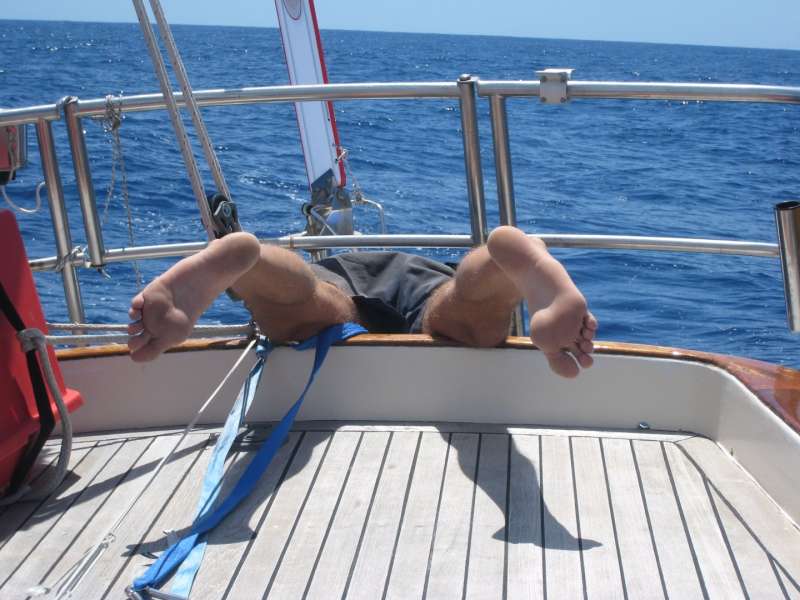

We have a Monitor windvane and have nothing but praise for the support the company Scanmar has given us over the years. It has a sacrifical post that is intended to break if the forces exceed a certain limit and comes with spares. We 've had to replace the post a couple of times. We have a Bowman 57, gross displacement 29 tons. Ours was the biggest boat fitted with the Monitor when we first bought it. The Monitor does an excellent job of steering, and yes balancing the sails first is important. We 've crossed the Atlantic three times with it. And yes, the ropes coming to the helm are at first a pain, but when crossing oceans, we rarely get behind the wheel, so it 's really only a bother near land. We disconnect the ropes when sailing short coastal hops. The picture is of Alex working on the Monitor mid-ocean while I kept an eye on Aleria while hove to. The next time I tied a rope to his ankle. [attachment=441]IMG_0431.JPG[/attachment]
