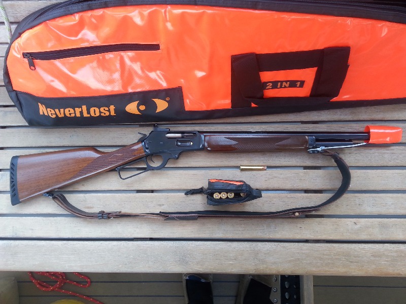

We purchased a Marlin 45-70 which looks similar to the classic Winchester repeater from the old cowboy films. Gun nerds will talk forever but it was recommended to us by an experienced Finn. I am left handed, my wife right handed do this gun is perfect for us. It is short and light
It holds 5 rounds and reloading does not stop you shooting unlike a bolt action. It has a very heavy slow bullet that is very effective at close range, this calibre is used extensively for hunting big dangerous game in close bush. More or less how a polar bear will approach, you do not need to shoot it until it is very close.
