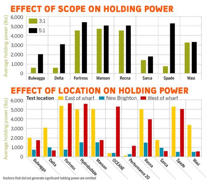

Hi Daria,
Has anyone else documented your observation that a Spade needs more scope than a Rocna to set? I pay a good deal of attention to ground tackle and anchoring techniques and this is a new observation to me.

We have aboard and use the Ultra as our primary and the Rocna as our storm anchor. We also have the Spade but find that it needs more scope than the other two. (After all, we write about anchors and anchoring so we have lots of them.)
As an endorsement of Spade over Rocna. You may mean that to be the message, but there are some concerns over Rocna’s design (and occasional problems in action) that leads many thoughtful sailors/experts to endorse a Spade over a Rocna.

Hi Dick,
In one of the better comparative tests of anchors published in SAIL magazine in October 2006, the effect of scope on holding power was evaluated. That test showed that the holding power of the Spade was excellent at 5:1 but significantly reduced at 3:1 scope. That was not the case for the Rocna, Manson Supreme, Fortress or Wasi(Bugel). Anchor tests always have their own issues but we have found that more scope is better for the Spade in our own experience.
We all know that more scope is better in general and we normally would never use less than 5:1, but sometimes (crowded anchorage, deep water) there is no other choice. I agree that the Spade is an excellent anchor. This finding is just something to be aware of.
