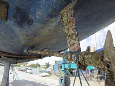

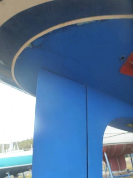

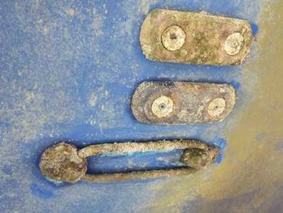

Before and after pictures of Serendipity with and without ultrasound. [attachment=149]image_2014-05-05.jpg[/attachment] [attachment=150]image_2014-05-05-2.jpg[/attachment] [attachment=151]image_2014-05-05-3.jpg[/attachment]
dcaukill - 05 May 2014
The first two pictures were of Serendipity in Fiji, hauled out and washed off five months after being anitfouled in Rodney Bay. The last picture is Serendipity hauled out and washed off in Grenada sixteen months after being anitfouled in Auckland - where i had the Ultrasound fitted. Not a barnacle nor strand of any other crustaeceous growth in sight, save for a very small amount of barnacles on the bowthruster, inside some of the through hulls and a very little in the gap between rudder an skeg. Result!
