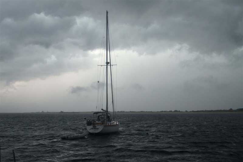

Thought you might like to see a picture of the event. Our anchor buoy is visible on the starboard side of our friends on Jamin... I would absolutely HATE to lose our 80lb Manson and 275ft of chain because of a fouled anchor and wonder about putting a spool of line on the pulpit? It would seem to make the whole deployment/retrieval process far more complicated however... I wonder if there 'd be a way to link the windlass to an electric winder on the spool - so that when retrieving, the spool takes up the slack in the trip line. The trip line could maybe be fishing line - such that if it 's needed, then use it as a messenger to send down a thicker trip line... All too complex?

Yep, sounds complicated. In our book, "Happy Hooking. The Art of Anchoring." we describe a way to retrieve a stuck anchor by shimmying a length of chain down the rode to the crown of the anchor from a dinghy; that 's after taking up the slack in the rode. Then you can use the dinghy to pull almost horizontally by the crown to free the anchor. There are also commercial anchor retrieval systems like Anchor Rescue, Anka-Yanka, and Anchor Witch among others. The Anchor Witch website has a demo video that shows it retrieving a Rocna. We 've only had one instance where that did not work. A friend anchored in a mooring field (always a bad idea)and got his anchor 's tip stuck in a link of a massive chain. It was wedged in so hard that it took several divers with equipment to free it. Neither a trip line nor any other retrieval system would have helped in that case.
