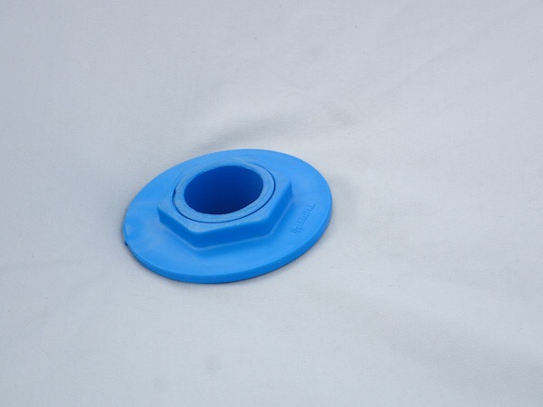

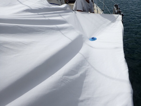

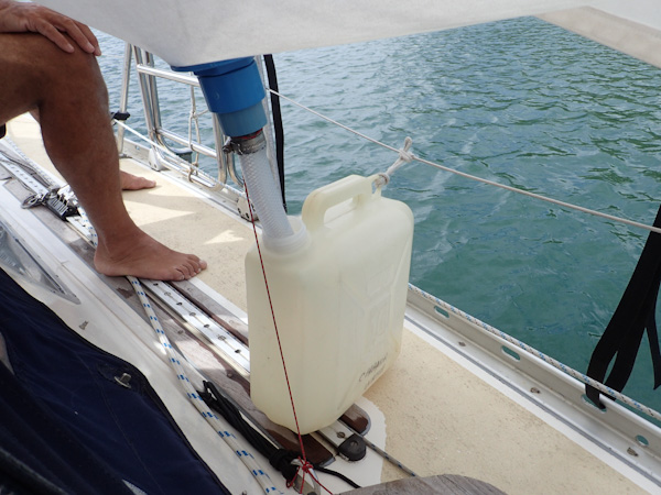

Caramor’s system:
A shade tarp with a hole in it. In the hole we have fitted the best piece of plumbing we could find, with a hose attached to it that feeds into a jerrycan. Once full we pour the jerrycan into the tank.
Downsides: we can’t use it underway, only a small area of our tarp is actually contributing, someone has to be on hand to empty the jerrycan.
