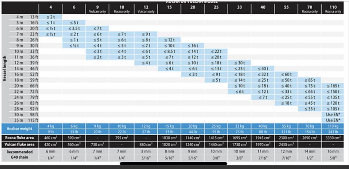

As you know I’m taking the cowards route and buying two Rocna anchors, while complying with manufacturer’s 50knot wind recommendations for insurance purposes.
My boat’s fully laden weight is 10T and I purchased the 20kg anchor. My secondary anchor only for emergency >force 10+ wind usage, will weigh less at 15kg.
My investigation provided this following data on boat length, boat weight, anchor weight and recommended chain;
Click To Enlarge
For me this data seems to be subject to anchor design versus boat length and weight. So this data is a little too complex for me to determine the relationship as linear or exponential 🤔
Hope this helps with your anchor weight and chain review and looking forward to reading your updated article.

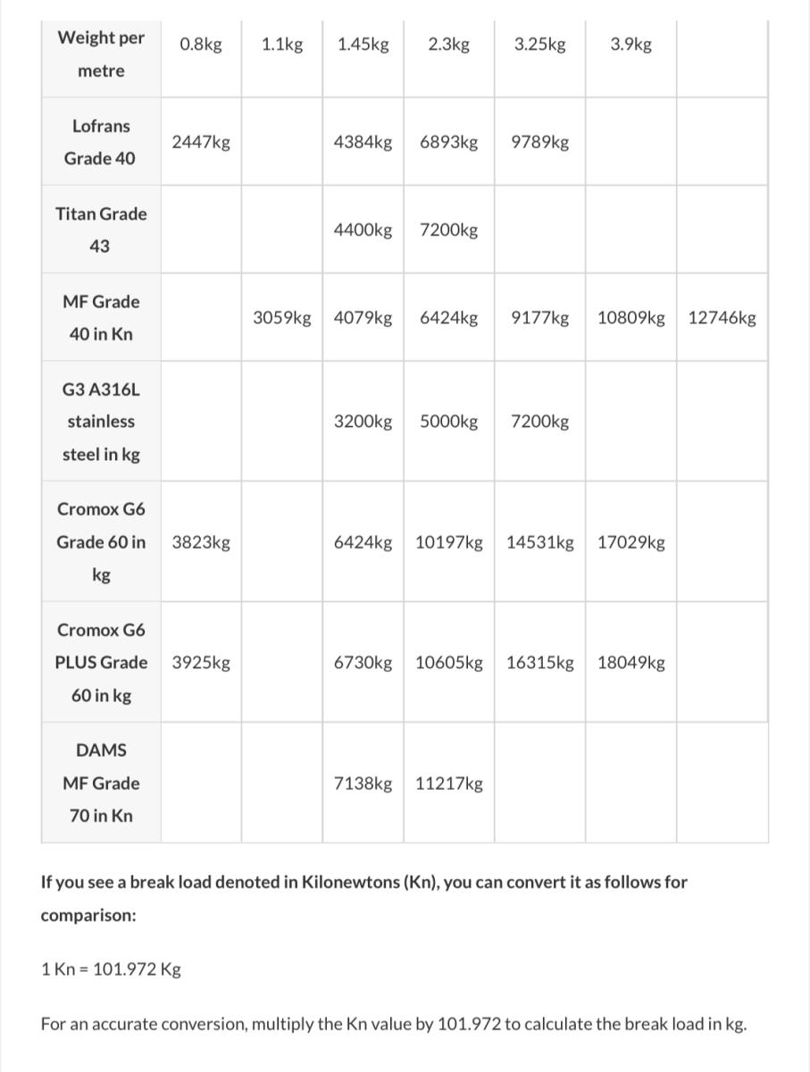

I understand the G10 (100N/mm chain) will be lighter, and appreciate you know it to be enough, but I believe the G10 is also weaker.
Also, to satisfy my insurance I must comply with Rocna’s G40 (400N/mm chain) recommendation for upto 50knots and also to benefit from the manufacturer’s warranty.
I also feel some chandleries have stopped selling anything less than G40. For example, found this interesting information on the Jimmy Green website;
Click To Enlarge
Click To Enlarge
Many thanks again and I hope this Jimmy Green table helps… Alternatively I also found another useful article link;
https://www.elitesalesinc.com/tag/industrial-chain-grades/
